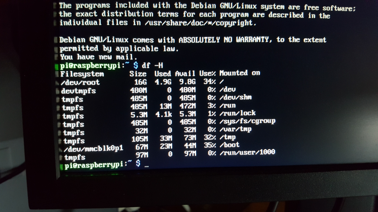

That is exactly the point, instead of digging in to SD card expansion, I am trying to understand why does Razberry need so mush space. Please see my df report attached, it looks like I have at least 9 GB free in /dev/root unless Razberry is getting installed into a different partition... - md screen.jpg (563.19 КБ) 16320 просмотров

Re: MajorDoMo with Z-Wave
I think that Razzberry installation script is trying to extract files to /tmp folder and it has only 100Mb available so it's getting out too quickly. Can you try following changes:
1. Go to /etc/ folder
2. Open /etc/fstab file
3. Remove or comment line with following code:
tmpfs /tmp tmpfs defaults,noatime,nosuid,size=100m 0 0
4. Reboot the system.
This should remove the 100Mb limit for /tmp folder so the all space available will be used.
