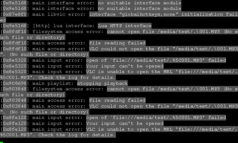

Ну так с линуемом кто победил или нет
Вот у меня что к консоли валится.

Тут явно проблема со слэшами при составлении пути в коде файла app_mediabrowser.php.
root@raspberrypi2:/var/log# vlc -I http
VLC media player 2.0.3 Twoflower (revision 2.0.2-93-g77aa89e)
[0xaf5530] inhibit interface error: Failed to connect to the D-Bus session daemon: Unable to autolaunch a dbus-daemon without a $DISPLAY for X11
[0xaf5530] main interface error: no suitable interface module
[0xa638f0] main libvlc error: interface "globalhotkeys,none" initialization failed
[0xaf5530] [http] lua interface: Lua HTTP interface
[0xb6a6d8] filesystem access error: cannot open file /media/music/.\minidisco\12-La-BOMBA.mp3 (No such file or directory)
[0xb6a6d8] main access error: File reading failed
[0xb6a6d8] main access error: VLC could not open the file "/media/music/.\minidisco\12-La-BOMBA.mp3". (No such file or directory)
[0x76400538] main input error: open of `file:///media/music/.%5Cminidisco%5C12-La-BOMBA.mp3' failed
[0x76400538] main input error: Your input can't be opened
[0x76400538] main input error: VLC is unable to open the MRL 'file:///media/music/.%5Cminidisco%5C12-La-BOMBA.mp3'. Check the log for details.

Насчет слэшей. Начиная с WinXP в путях можно использовать не только \, но и /.
