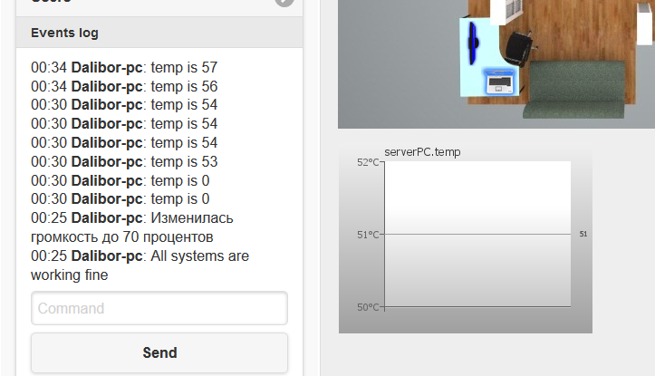

Also, even when I run the script manually every minute I do not get the graph to display history. I use this code for the graph
<img src="/pChart/?p=serverPC.temp&type=30m&width=280">
Type: HTML
the graph always shows 51C +- 1C, like this
Temp Graph
Temp Graph
Skjermbilde 2015-11-15 00.44.13.png (82.37 КБ) 19464 просмотра
How to activate the graph? How to call the script every minute on most "correct" way? Any optimization to the setup above?

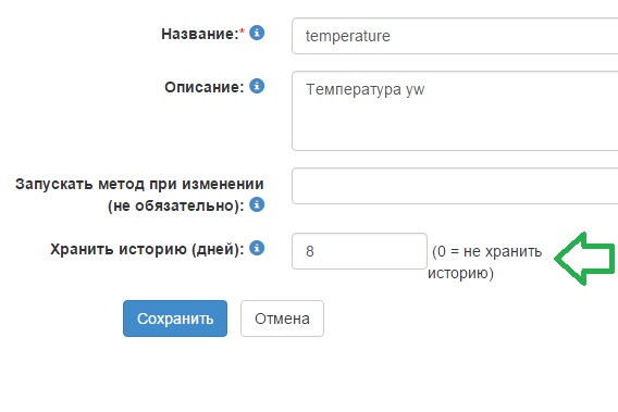

Set the properties of the class - save history.

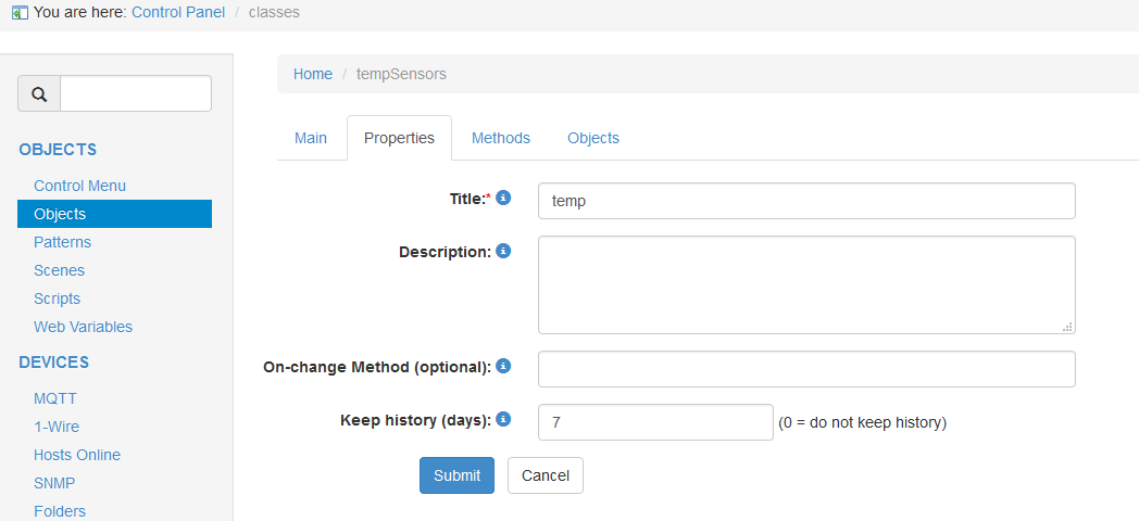

Than you for reply, it is already set to 7 by default on the master class

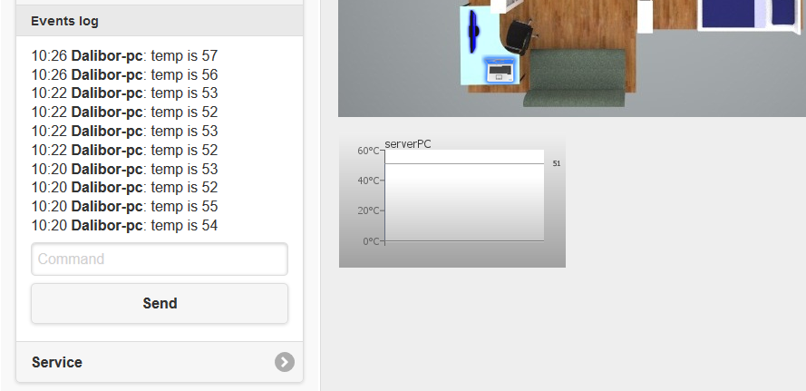

It looks better now, but still no history of the data.
Screenshot 2015-11-15 10.27.01.png (89.91 КБ) 19428 просмотров
I am suspecting that code in the script is not quite right, is this the right way to store temperature?
sg('serverPC.temp', $obj->Value);
callMethod('serverPC.tempChanged');
I tried looking at the demo, I see now that it is temporarily disabled. Is there some detailed API documentation/cheatsheet?
I see examples on the website and forum, but is there one centralized technical documentation on how to do things?

I've changed type=8d to type=8h and now data appears nice (I also removed &scale=zero).
I've also called the script inside the onNewMinute for now, until i figure out better way to schedule a script
Thanks for the help!
