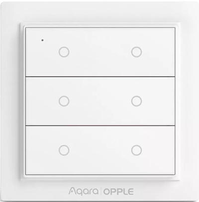

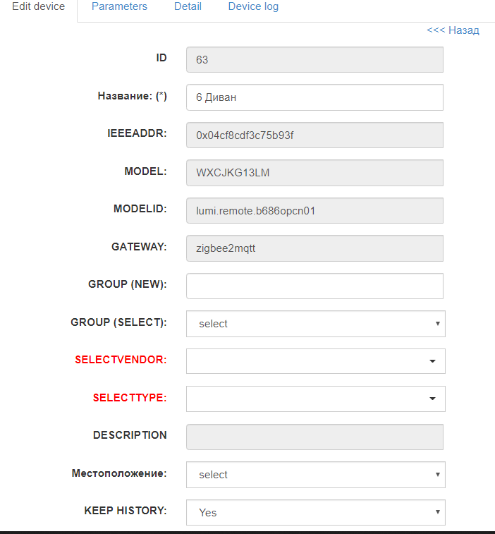

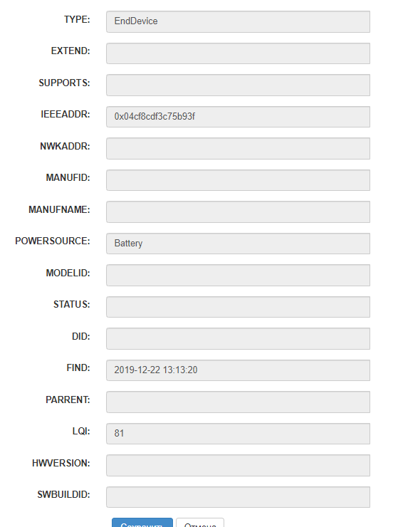

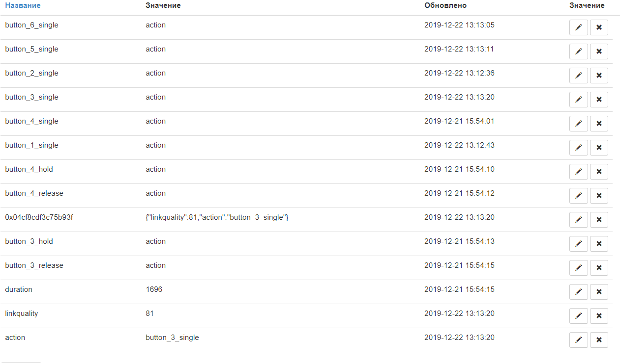

Прошу добавить настенные выключатели (пульты) Aqara x OPPLE Zig Bee 3.0 WXCJKG13LM
Изображение пульта
button_6_single action 2019-12-22 13:13:05
button_5_single action 2019-12-22 13:13:11
button_2_single action 2019-12-22 13:12:36
button_3_single action 2019-12-22 13:13:20
button_4_single action 2019-12-21 15:54:01
button_1_single action 2019-12-22 13:12:43
button_4_hold action 2019-12-21 15:54:10
button_4_release action 2019-12-21 15:54:12

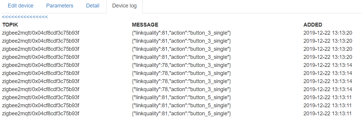

0x04cf8cdf3c75b93f {"linkquality":81,"action":"button_3_single"} 2019-12-22 13:13:20
button_3_hold action 2019-12-21 15:54:13
button_3_release action 2019-12-21 15:54:15
duration 1696 2019-12-21 15:54:15
linkquality 81 2019-12-22 13:13:20
action button_3_single 2019-12-22 13:13:20Код: Выделить всё
TOPIK MESSAGE ADDED
zigbee2mqtt/0x04cf8cdf3c75b93f {"linkquality":81,"action":"button_3_single"} 2019-12-22 13:13:20
zigbee2mqtt/0x04cf8cdf3c75b93f {"linkquality":78,"action":"button_3_single"} 2019-12-22 13:13:14
zigbee2mqtt/0x04cf8cdf3c75b93f {"linkquality":81,"action":"button_5_single"} 2019-12-22 13:13:11
zigbee2mqtt/0x04cf8cdf3c75b93f {"linkquality":81,"action":"button_5_single"} 2019-12-22 13:13:08
zigbee2mqtt/0x04cf8cdf3c75b93f {"linkquality":81,"action":"button_5_single"} 2019-12-22 13:13:08SPOILERSPOILER_SHOW
