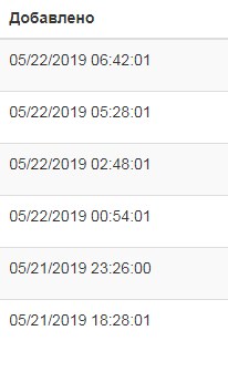

и коры на жпс приходят с интервалом то 2 мин , то 40 мин. или вообщем.., почему?
- Screenshot_3.jpg (14.27 КБ) 4917 просмотров

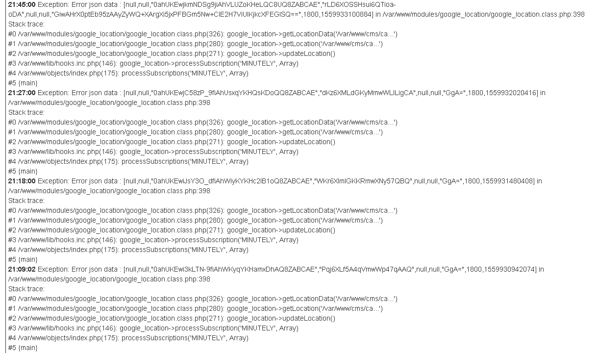

07:37:00 Exception: Error json data : [null,null,"0ahUKEwjNgNuvwtHiAhV866YKHSkEACgQ8ZABCAE","7Eb3XM3aIPzWmwWpiIDAAg",null,null,"GgA=",1800,1559709420548] in /var/www/html/modules/google_location/google_location.class.php:397
Stack trace:
#0 /var/www/html/modules/google_location/google_location.class.php(325): google_location->getLocationData('/var/www/html/c...')
#1 /var/www/html/modules/google_location/google_location.class.php(280): google_location->getLocation('/var/www/html/c...')
#2 /var/www/html/modules/google_location/google_location.class.php(271): google_location->updateLocation()
#3 /var/www/html/lib/hooks.inc.php(146): google_location->processSubscription('MINUTELY', Array)
#4 /var/www/html/objects/index.php(175): processSubscriptions('MINUTELY', Array)
#5 {main}
07:37:00

- Eraser
- Сообщения: 1085
- Зарегистрирован: Вт окт 21, 2014 7:31 pm
- Откуда: Киров
Re: [Модуль] Google Location
cookies не действительныеMaksimov73 писал(а): Ср июн 05, 2019 7:39 am и так по кругуSPOILERSPOILER_SHOW07:37:00 Exception: Error json data : [null,null,"0ahUKEwjNgNuvwtHiAhV866YKHSkEACgQ8ZABCAE","7Eb3XM3aIPzWmwWpiIDAAg",null,null,"GgA=",1800,1559709420548] in /var/www/html/modules/google_location/google_location.class.php:397

Создал новый файл-теперь такой ответ
11:53:01 Exception: Error connection : 302 => {"http_code":"HTTP\/1.1 302 Found","Location":"https:\/\/www.google.com\/sorry\/index?continue=https:\/\/www.google.com\/maps\/preview\/locationsharing\/read%3Fauthuser%3D0%26hl%3Dru%26gl%3Dru%26pb%3D&hl=ru&q=EgRV7SOSGO2F3ucFIhkA8aeDS5PsoHHo1nQBQxhgVYHbCyrtahLuMgFy","Date":"Wed, 05 Jun 2019 08:53:01 GMT","Pragma":"no-cache","Expires":"Fri, 01 Jan 1990 00:00:00 GMT","Cache-Control":"no-store, no-cache, must-revalidate","Content-Type":"text\/html; charset=UTF-8","Server":"HTTP server (unknown)","Content-Length":"413","X-XSS-Protection":"0","Alt-Svc":"quic=\":443\"; ma=2592000; v=\"46,44,43,39\""} in /var/www/html/modules/google_location/google_location.class.php:388

- Eraser
- Сообщения: 1085
- Откуда: Киров
забанили васMaksimov73 писал(а): Ср июн 05, 2019 11:54 am Создал новый файл-теперь такой ответSPOILERSPOILER_SHOW11:53:01 Exception: Error connection : 302 => {"http_code":"HTTP\/1.1 302 Found","Location":"https:\/\/www.google.com\/sorry\/index?continue=https:\/\/www.google.com\/maps\/preview\/locationsharing\/read%3Fauthuser%3D0%26hl%3Dru%26gl%3Dru%26pb%3D&hl=ru&q=EgRV7SOSGO2F3ucFIhkA8aeDS5PsoHHo1nQBQxhgVYHbCyrtahLuMgFy","Date":"Wed, 05 Jun 2019 08:53:01 GMT","Pragma":"no-cache","Expires":"Fri, 01 Jan 1990 00:00:00 GMT","Cache-Control":"no-store, no-cache, must-revalidate","Content-Type":"text\/html; charset=UTF-8","Server":"HTTP server (unknown)","Content-Length":"413","X-XSS-Protection":"0","Alt-Svc":"quic=\":443\"; ma=2592000; v=\"46,44,43,39\""} in /var/www/html/modules/google_location/google_location.class.php:388
