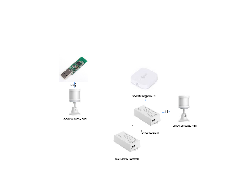

Сообщение SrFatCat »
Карту строит с ошибками.
Вот моя:
Opera Снимок_2019-04-30_143351_srfatcat-mjd.vpnki.ru.png (47.8 КБ) 4436 просмотров
Нет связи между координатором и роутером OnOff *****7031, зато между двумя OnOff'ами 2 связи одинаковые.
В ответе z2m то, все вроде норм:
2019-4-30 14:35:35 - info: MQTT publish: topic 'zigbee2mqtt/bridge/networkmap/raw', payload '[{"ieeeAddr":"0x00158d0002e277eb","nwkAddr":18497,"lqi":170,"parent":"0x00124b001936dbe0","status":"online"},{"ieeeAddr":"0x00158d0002ec3034","nwkAddr":24305,"lqi":42,"parent":"0x00124b001936dbe0","status":"online"},{"ieeeAddr":"0x01124b001bae74d7","nwkAddr":34610,"lqi":31,"parent":"0x00124b001936dbe0","status":"offline"},{"ieeeAddr":"0x01124b001bae7031","nwkAddr":12373,"lqi":27,"parent":"0x00124b001936dbe0","status":"offline"},{"ieeeAddr":"0x00158d000309b77f","nwkAddr":11757,"lqi":170,"parent":"0x00124b001936dbe0","status":"online"},{"ieeeAddr":"0x00124b001936dbe0","nwkAddr":0,"lqi":1,"parent":"0x01124b001bae74d7","status":"online"},{"ieeeAddr":"0x01124b001bae7031","nwkAddr":12373,"lqi":45,"parent":"0x01124b001bae74d7","status":"offline"},{"ieeeAddr":"0x00124b001936dbe0","nwkAddr":0,"lqi":1,"parent":"0x01124b001bae7031","status":"online"},{"ieeeAddr":"0x00158d0002e277eb","nwkAddr":18497,"lqi":18,"parent":"0x01124b001bae7031","status":"online"},{"ieeeAddr":"0x00158d000309b77f","nwkAddr":11757,"lqi":70,"parent":"0x01124b001bae7031","status":"online"},{"ieeeAddr":"0x01124b001bae74d7","nwkAddr":34610,"lqi":48,"parent":"0x01124b001bae7031","status":"offline"}]'

SrFatCat писал(а): Вт апр 30, 2019 2:42 pm Карту строит с ошибками.
точно такая же фигня. онофф связан с лампочкой и обратно.
