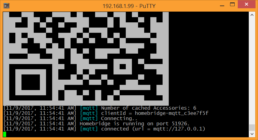

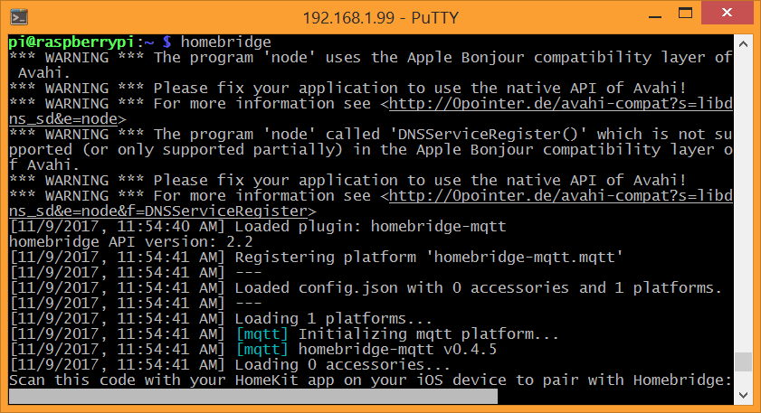

Помогите пожалуйста разобраться с Homebridge..
IPad его не видит ни в какую..
Папку persist/ уже удалял, сам homebridge и homebridge-mqtt обновил
homebridge.errSPOILER_SHOW
*** WARNING *** Please fix your application to use the native API of Avahi!
*** WARNING *** For more information see <http://0pointer.de/avahi-compat?s=libdn ... ceRegister>
Thu, 09 Nov 2017 07:18:07 GMT EventedHTTPServer Server listening on port 51926
*** WARNING *** The program 'node' uses the Apple Bonjour compatibility layer of Avahi.
*** WARNING *** For more information see <http://0pointer.de/avahi-compat?s=libdns_sd&e=node>
*** WARNING *** The program 'node' called 'DNSServiceRegister()' which is not supported (or only supported partially) in the Apple Bonjour compatibility layer of Avahi.

homebridge.logSPOILER_SHOW
[11/9/2017, 11:35:22 AM] [mqtt] addAccessory true, accessory 'Switch2', service_name 'Свет Аквариум' is added.
[11/9/2017, 11:35:22 AM] [mqtt] removeAccessory true, accessory 'Switch3' is removed.
[11/9/2017, 11:35:22 AM] [mqtt] addAccessory true, accessory 'Switch3', service_name 'Switch 3' is added.
[11/9/2017, 11:35:22 AM] [mqtt] removeAccessory true, accessory 'TempSensor01' is removed.
[11/9/2017, 11:35:22 AM] [mqtt] addAccessory true, accessory 'TempSensor01', service_name 'Температура дома' is added.
[11/9/2017, 11:35:22 AM] [mqtt] removeAccessory true, accessory 'MotionSensor1' is removed.
[11/9/2017, 11:35:22 AM] [mqtt] addAccessory true, accessory 'MotionSensor1', service_name 'Датчик движения 1' is added.
[11/9/2017, 11:35:22 AM] [mqtt] removeAccessory true, accessory 'Sensor_temp02' is removed.
[11/9/2017, 11:35:22 AM] [mqtt] addAccessory true, accessory 'Sensor_temp02', service_name 'Датчик Температуры Аквариум' is added.
- log.png (25.3 КБ) 7165 просмотров
- log1.png (46.39 КБ) 7165 просмотров
