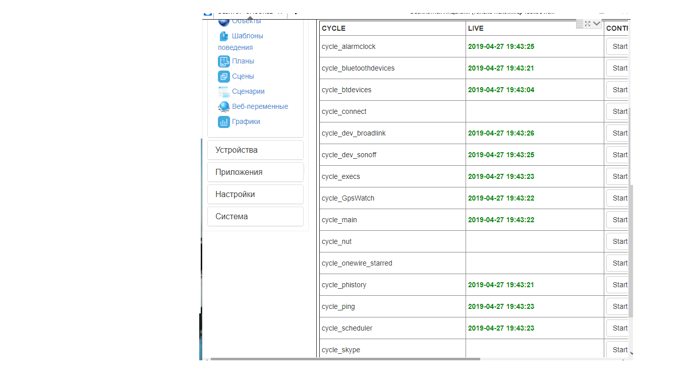

и еще такое пишет... File: Lines:
10:16:44 0.66382000 [http] +++ {"error":401}
PS как я понял, большой файл, это данные которые считывает мд, ошибка 401 возникает, когда сменился токен... это все более менее понятно, но как же понять, по какой причине не запускается цикл... как я понимаю, цикл должен в любом случае запуститься, другое дело, если что, просто не будет отражаться реальные состояния устройств сонофф. но как понять и где выяснить причины не запуска цикла??? вот в чем вопрос...
22:08:58 0.97031300 [http] +++ [{"_id":","name":"Ванная ВЕНТИЛЯЦИЯ 0dc762","type":"10","deviceid":"12","apikey":"","extra":{"_id":","extra":{"description":"WWJG000898","brandId":"561","apmac":"","mac":"4","ui":"恒温恒湿改装件","modelInfo":"5","model":"PSA-BHA-GL","manufacturer":"深圳创易智能系统有限公司","uiid":15,"staMac":""}},"__v":0,"onlineTime":"2019-04-23T23:31:16.280Z","ip":","location":"","offlineTime":"2019-04-2Z","deviceStatus":"","settings":{"alarmNotify":1,"opsHistory":1,"opsNotify":1},"groups":[],"params":{"init":1,"switch":"off","targets":[{"reaction":{"switch":"on"},"targetHigh":"73"},{"reaction":{"switch":"off"},"targetLow":"72"}],"fwVersion":"2.6.0","sensorType":"AM2301","currentHumidity":"30","startup":"off","currentTemperature":"28","staMac":"","rssi":-62,"mainSwitch":"on","deviceType":"humidity"},"online":true,"createdAt":"2018-03-26T17:29:12.071Z","group":"","sharedTo":[],"devicekey":"","deviceUrl":"","brandName":"Maker","showBrand":true,"brandLogoUrl":"","productModel":"Sonoff THS","uiid":15},{"_id":"","name":"Гостинная","type":"10","deviceid":"3","apikey":"","extra":{"_id":"e","extra":{"description":"WWJG000997","brandId":","apmac":","mac":"6","ui":"开关改装模块","modelInfo":"","model":"ITA-GZ1-GL","manufacturer":"深圳创易智能系统有限公司","uiid":14}},"__v":0,"offlineTime":"2017-12-04T09:27:30.532Z","deviceStatus":"","settings":{"opsNotify":0,"opsHistory":1,"alarmNotify":1},"groups":[],"online":false,"createdAt":"2017-09-15T13:49:10.809Z","group":"","sharedTo":[],"devicekey":","deviceUrl":"","brandName":"Maker","showBrand":true,"brandLogoUrl":"","productModel":"Sonoff","uiid":14},{"_id":"5","name":"Моё устройство 124d03","type":"10","deviceid":"1000124d03","apikey":"","extra":{"_id":","extra":{"description":"WWJG000997","brandId":","apmac":"","mac":"d6","ui":"开关改装模块","modelInfo":"5ba","model":"ITA-GZ1-GL","manufacturer":"深圳创易智能系统有限公司","uiid":14}},"__v":0,"offlineTime":"2017-12-19T13:29:04.187Z","onlineTime":"2017-12-1,"ip":","location":"","deviceStatus":"","settings":{"alarmNotify":1,"opsHistory":1,"opsNotify":1},"groups":[],"params":{"switch":"on","fwVersion":"1.5.5","startup":"on","staMac":"5C:CF:7F:BB:12:4B","rssi":-73},"online":false,"createdAt":"2017-12-06T17:45:39.489Z","group":"","sharedTo":[],"devicekey":"

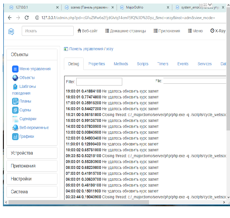

Привет всем...пришлось поваляться в больничке... вернулся, а тут народ веб сокет тестирует... короче пока остался на http, на сокетах у меня цикл не стартует... хотя считаю что 30 секунд (у меня стока стоит период) это более чем достаточно для обновления, так что не парюсь, жду правок и живу по старому

Только что проверил, цикл не упал, ошибок в системе нету, винда 10 ка. Все нормально, пока.
