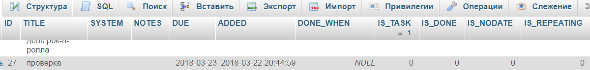

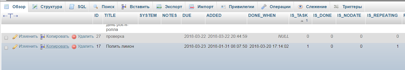

Re: Календарь/менеджер задач
задача
Array ( [0] => Array ( [ID] => 27 [TITLE] => проверка [SYSTEM] => [NOTES] => [DUE] => 2018-03-23 [ADDED] => 2018-03-22 20:44:59 [DONE_WHEN] => [IS_TASK] => 1 [IS_DONE] => 0 [IS_NODATE] => 0 [IS_REPEATING] => 0 [REPEAT_TYPE] => 1 [WEEK_DAYS] => [IS_REPEATING_AFTER] => 0 [REPEAT_IN] => 3 [USER_ID] => 5 [LOCATION_ID] => 0 [CALENDAR_CATEGORY_ID] => 2 [DONE_SCRIPT_ID] => 0 [DONE_CODE] => [LOG] => [ICON] => ) )
переделал ее на событие
т.е. полностью пусто
  $events_early_today=SQLSelect("SELECT calendar_events.*,calendar_categories.ICON FROM calendar_events left join calendar_categories on calendar_events.calendar_category_id=calendar_categories.id  WHERE TO_DAYS(DATE(CONCAT_WS('-', DATE_FORMAT(NOW(), '%Y'), DATE_FORMAT(DUE, '%m'), DATE_FORMAT(DUE, '%d'))))=TO_DAYS(NOW()) AND IS_REPEATING=1 AND REPEAT_TYPE=1 AND IS_TASK=0  ORDER BY IS_TASK DESC");
  if ($events_early_today) {
   foreach($events_early_today as $k=>$v) {
    $events_today[]=$v;
    //$calendar_categories[$k1]['EVENTS_TODAY'][]=$v;
  $events_monthly_today=SQLSelect("SELECT calendar_events.*,calendar_categories.ICON FROM calendar_events left join calendar_categories on calendar_events.calendar_category_id=calendar_categories.id  WHERE TO_DAYS(DATE(CONCAT_WS('-', DATE_FORMAT(NOW(), '%Y'), DATE_FORMAT(NOW(), '%m'), DATE_FORMAT(DUE, '%d'))))=TO_DAYS(NOW()) AND IS_REPEATING=1 AND REPEAT_TYPE=2 AND IS_TASK=0  ORDER BY IS_TASK DESC");
  if ($events_monthly_today) {
   foreach($events_monthly_today as $k=>$v) {
    $events_today[]=$v;
  $events_weekly_today=SQLSelect("SELECT calendar_events.*,calendar_categories.ICON FROM calendar_events left join calendar_categories on calendar_events.calendar_category_id=calendar_categories.id  WHERE DATE_FORMAT(DUE, '%w')=DATE_FORMAT(NOW(), '%w') AND IS_REPEATING=1 AND REPEAT_TYPE=3 AND IS_TASK=0  ORDER BY IS_TASK DESC");
  if ($events_weekly_today) {
   foreach($events_weekly_today as $k=>$v) {
    $events_today[]=$v;
  if ($events_today) {
   $out['EVENTS_TODAY']=$events_today;
IS_REPEATING=1 я хз, не оно
в событие (но я хз что сделал, в смысле на что это влияет)
Array ( [0] => Array ( [ID] => 27 [TITLE] => проверка [SYSTEM] => [NOTES] => [DUE] => 2018-03-23 [ADDED] => 2018-03-22 20:44:59 [DONE_WHEN] => [IS_TASK] => 0 [IS_DONE] => 0 [IS_NODATE] => 0 [IS_REPEATING] => 0 [REPEAT_TYPE] => 1 [WEEK_DAYS] => [IS_REPEATING_AFTER] => 0 [REPEAT_IN] => 3 [USER_ID] => 5 [LOCATION_ID] => 0 [CALENDAR_CATEGORY_ID] => 2 [DONE_SCRIPT_ID] => 0 [DONE_CODE] => [LOG] => [ICON] => ) )
это я ей повтор не поставил?
