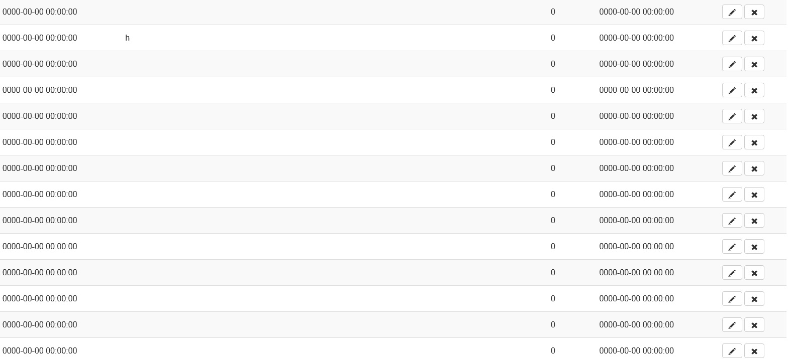

Warning: Illegal string offset 'document' in C:\_majordomo\htdocs\modules\app_check\app_check.class.php on line 173 Warning: Illegal string offset 'receipt' in C:\_majordomo\htdocs\modules\app_check\app_check.class.php on line 173 Warning: Illegal string offset 'user' in C:\_majordomo\htdocs\modules\app_check\app_check.class.php on line 174 h Warning: Illegal string offset 'fiscalSign' in C:\_majordomo\htdocs\modules\app_check\app_check.class.php on line 175 Warning: Illegal string offset 'document' in C:\_majordomo\htdocs\modules\app_check\app_check.class.php on line 173 Warning: Illegal string offset 'receipt' in C:\_majordomo\htdocs\modules\app_check\app_check.class.php on line 173 Warning: Illegal string offset 'user' in C:\_majordomo\htdocs\modules\app_check\app_check.class.php on line 174 h Warning: Illegal string offset 'fiscalSign' in C:\_majordomo\htdocs\modules\app_check\app_check.class.php on line 175 Warning: Illegal string offset 'document' in C:\_majordomo\htdocs\modules\app_check\app_check.class.php on line 173 Warning: Illegal string offset 'receipt' in C:\_majordomo\htdocs\modules\app_check\app_check.class.php on line 173 Warning: Illegal string offset 'user' in C:\_majordomo\htdocs\modules\app_check\app_check.class.php on line 174 � Warning: Illegal string offset 'fiscalSign' in C:\_majordomo\htdocs\modules\app_check\app_check.class.php on line 175 Warning: Illegal string offset 'dateTime' in C:\_majordomo\htdocs\modules\app_check\app_check.class.php on line 179 Warning: Illegal string offset 'fiscalSign' in C:\_majordomo\htdocs\modules\app_check\app_check.class.php on line 180 Warning: Illegal string offset 'user' in C:\_majordomo\htdocs\modules\app_check\app_check.class.php on line 181 Warning: Illegal string offset 'operator' in C:\_majordomo\htdocs\modules\app_check\app_check.class.php on line 182 Warning: Illegal string offset 'retailPlaceAddress' in C:\_majordomo\htdocs\modules\app_check\app_check.class.php on line 183 Warning: Illegal string offset 'totalSum' in C:\_majordomo\htdocs\modules\app_check\app_check.class.php on line 184 Warning: Illegal string offset 'items' in C:\_majordomo\htdocs\modules\app_check\app_check.class.php on line 186 Warning: Invalid argument supplied for foreach() in C:\_majordomo\htdocs\modules\app_check\app_check.class.php on line 187 Warning: Illegal string offset 'document' in C:\_majordomo\htdocs\modules\app_check\app_check.class.php on line 173 Warning: Illegal string offset 'receipt' in C:\_majordomo\htdocs\modules\app_check\app_check.class.php on line 173 Warning: Illegal string offset 'user' in C:\_majordomo\htdocs\modules\app_check\app_check.class.php on line 174 � Warning: Illegal string offset 'fiscalSign' in C:\_majordomo\htdocs\modules\app_check\app_check.class.php on line 175 Warning: Illegal string offset 'dateTime' in C:\_majordomo\htdocs\modules\app_check\app_check.class.php on line 179 Warning: Illegal string offset 'fiscalSign' in C:\_majordomo\htdocs\modules\app_check\app_check.class.php on line 180 Warning: Illegal string offset 'user' in C:\_majordomo\htdocs\modules\app_check\app_check.class.php on line 181 Warning: Illegal string offset 'operator' in C:\_majordomo\htdocs\modules\app_check\app_check.class.php on line 182 Warning: Illegal string offset 'retailPlaceAddress' in C:\_majordomo\htdocs\modules\app_check\app_check.class.php on line 183 Warning: Illegal string offset 'totalSum' in C:\_majordomo\htdocs\modules\app_check\app_check.class.php on line 184 Warning: Illegal string offset 'items' in C:\_majordomo\htdocs\modules\app_check\app_check.class.php on line 186 Warning: Invalid argument supplied for foreach() in C:\_majordomo\htdocs\modules\app_check\app_check.class.php on line 187 Warning: Illegal string offset 'document' in C:\_majordomo\htdocs\modules\app_check\app_check.class.php on line 173 Warning: Illegal string offset 'receipt' in C:\_majordomo\htdocs\modules\app_check\app_check.class.php on line 173 Warning: Illegal string offset 'user' in C:\_majordomo\htdocs\modules\app_check\app_check.class.php on line 174 � Warning: Illegal string offset 'fiscalSign' in C:\_majordomo\htdocs\modules\app_check\app_check.class.php on line 175 Warning: Illegal string offset 'dateTime' in C:\_majordomo\htdocs\modules\app_check\app_check.class.php on line 179 Warning: Illegal string offset 'fiscalSign' in C:\_majordomo\htdocs\modules\app_check\app_check.class.php on line 180 Warning: Illegal string offset 'user' in C:\_majordomo\htdocs\modules\app_check\app_check.class.php on line 181 Warning: Illegal string offset 'operator' in C:\_majordomo\htdocs\modules\app_check\app_check.class.php on line 182 Warning: Illegal string offset 'retailPlaceAddress' in C:\_majordomo\htdocs\modules\app_check\app_check.class.php on line 183 Warning: Illegal string offset 'totalSum' in C:\_majordomo\htdocs\modules\app_check\app_check.class.php on line 184 Warning: Illegal string offset 'items' in C:\_majordomo\htdocs\modules\app_check\app_check.class.php on line 186 Warning: Invalid argument supplied for foreach() in C:\_majordomo\htdocs\modules\app_check\app_check.class.php on line 187

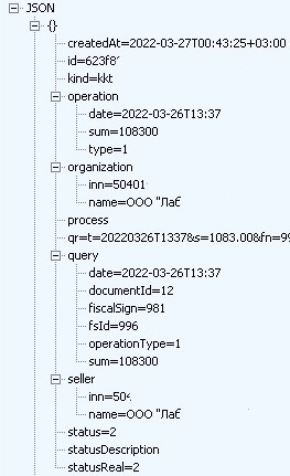

При нажатии кнопки "Refresh" ошибка "Warning: Invalid argument supplied for foreach() in C:\_majordomo\htdocs\modules\app_check\app_check.class.php on line 172".
Также попробовал отснифить трафик приложения. Насколько я понял поменялся адрес и поля в json:
Подскажите, плиз, как исправить.

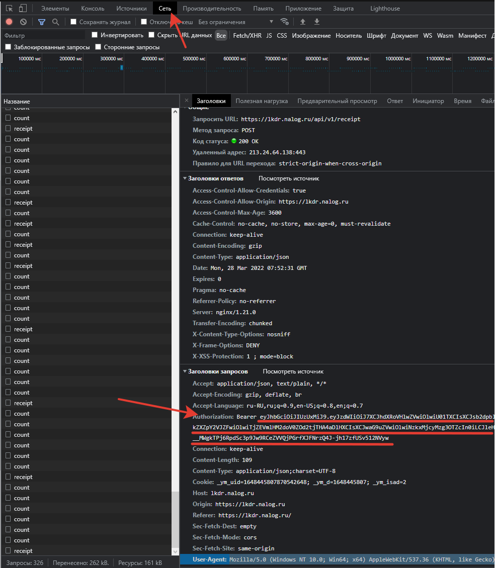

думаю стоит посмотреть в сторону сервиса https://lkdr.nalog.ru/
теперь модуль получает данные из https://lkdr.nalog.ru/
Для получения данных нужен токен
Для этого надо авторизоваться на https://lkdr.nalog.ru/, открыть в браузере консоль разработчика, вкладку сеть, в запросах найти Authorisation, скопировать в настройки модуля (на картинке понятнее \/)
Connect ---- Telegram
